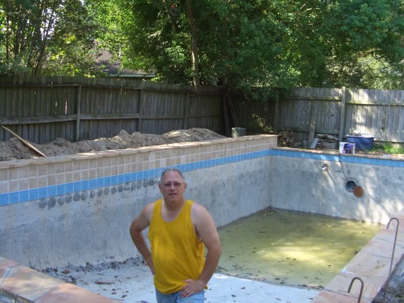

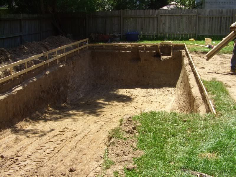

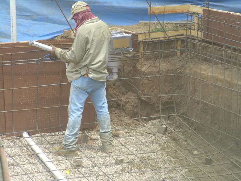

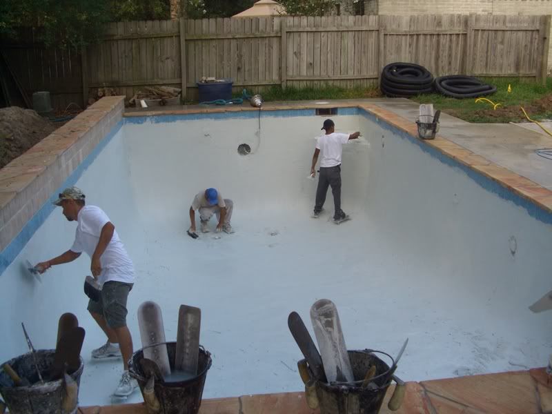

I have a 20K swimming pool in the backyard, picture below, it is a salt water pool and I highly recommend that option. It does away with having to worry about adding or storing chlorine. I use the dry acid (ph minus) and in the summer have to add a 5 of pounds per week, maybe a little more, depending on usage. They are now coming out with a seperate chemical that can reduce even that. With the robot skimmer my maintenance consists of adding the acid, brushing the pool twice a week, skimming before swimming, and cleaning the paper filter cartridges once a month (we have a black lab and it is her 20K dog toy!), and manually vacuming it in the spring due to some chinese tallow trees in the area. I would also recommend a pool cover for use in the fall and winter. In the fall it will help keep the water temps up for a few weeks and in the winter keeps all sorts of crap out of the pool. I take it off as needed to clean it during those seasons and in the summer it rolls up on a big spindle and sits out of the way against the fence. My electric bill did not go up noticably and since I did not have a spa or heater put in, my gas bill was untouched.
Two things I would have done differently if I were reconstructing, one, skip any type of flag stone. They all melt for lack of a better word when exposed to the pool chemicals. We had to have the 3 low sides completely redone and although the new stone is much tougher, it is still melting. Go with brick or even better for what you have in mind, have them install a tanning shelf all the way round the pool with a raised curb between it and the deck. The tanning self will sit in 2-3 inches of water and give the divers a place to sit and get ready to dive.
Two, they were just coming on to the market when we built and I wish I had paid the money for one, a solar heater. We don't have any type of heater on our pool because in asking around I found that our gas bill would jump astronomically in the winter to keep that body of water warm enough to swim in. I've read some pretty interesting material about the newest generation of solar heaters and I'm still trying to think of a way to re-engineer my pool to accomodate one without having to tear up a lot of deck to do it.
Anyway, imo the salt water feels better than a chlorinated pool. You don't have that sticky feeling when you get out and your eyes don't burn. On top of that your hair won't bleach and your bathing suit will last a lot longer. To me it just feels better and the savings in chlorine purchases plus the not having to hassle with it makes up for the chlorinator pretty quickly. Good luck, get a number of bids, and check to make sure every little detail is in the contract before you sign it. Depending on the contractor it can be kind of tough to make any changes after signing. Also, check warranties and the contractors responsibility. We were and continue to be extremely pleased with the family business that did our work and I hope you have the same luck. Here's our decompression area!!! And I found some shots of it under construction as well.
