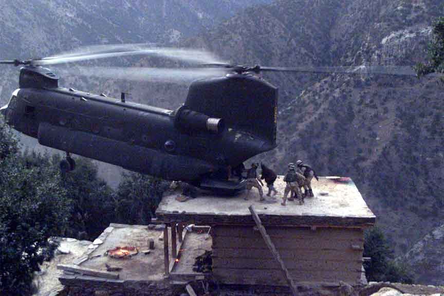

Click Click D'oh (Photo Quality Screener & Founding Member) 21 Jun 10, 20:25Post
I hope they practice these half landing extractions a lot.
