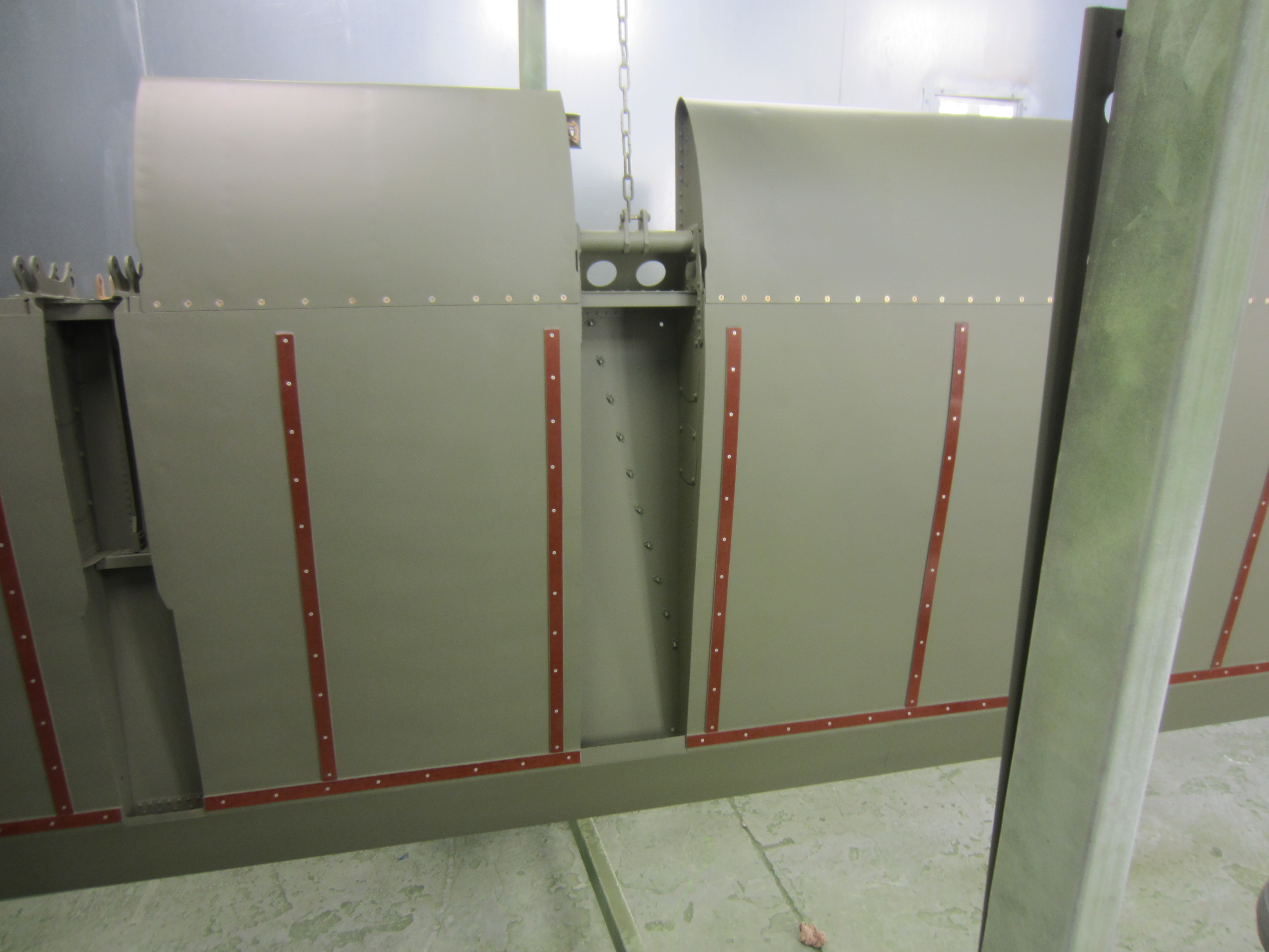

miamiair (netAirspace FAA) 26 Aug 13, 13:20Post

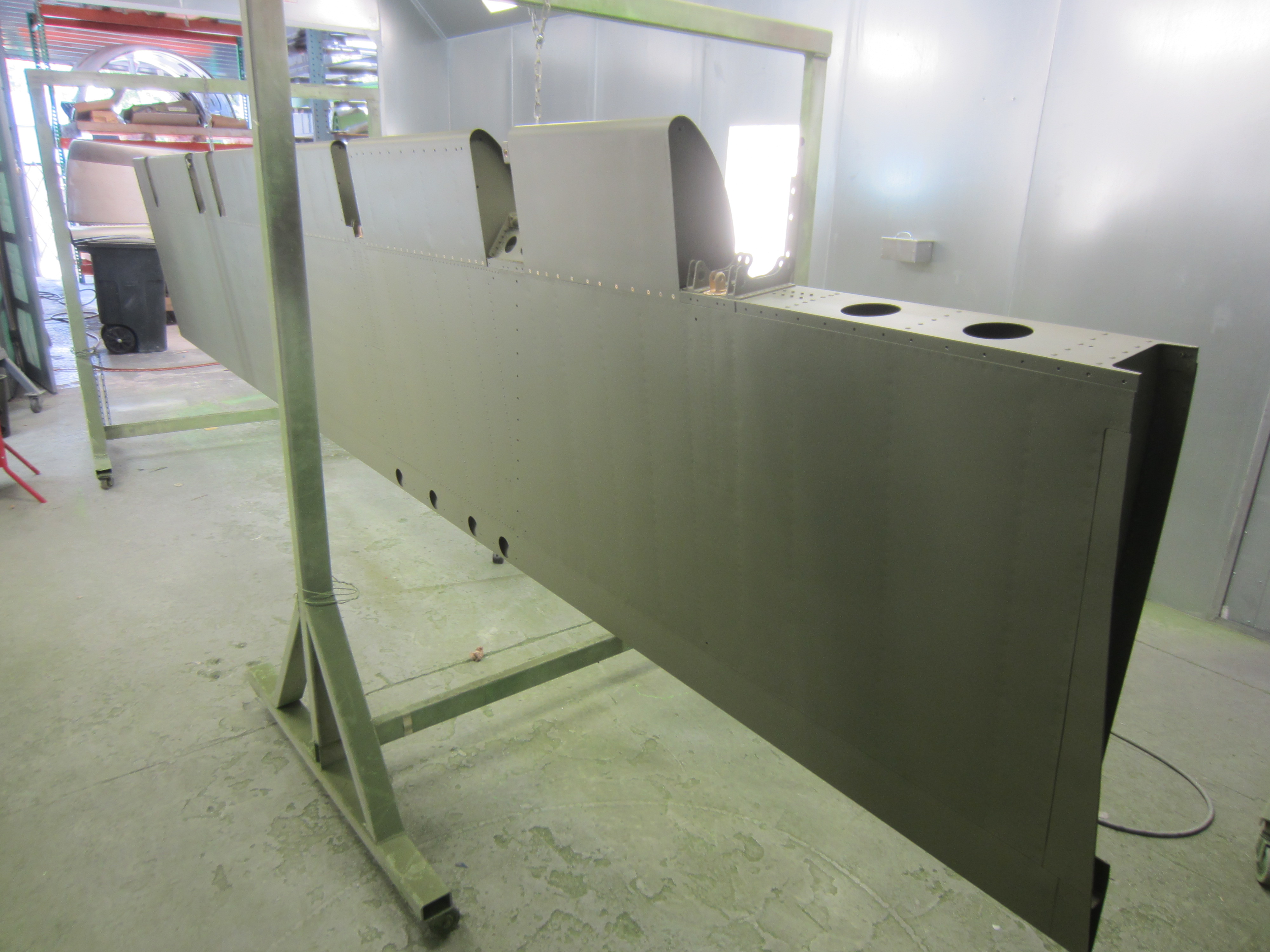

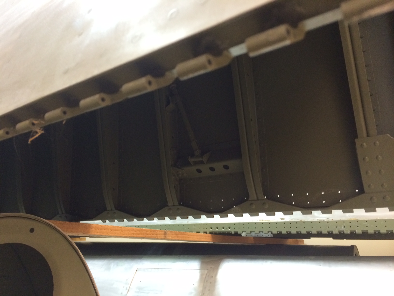

Some "after" photos of the inboard flap:
Fumanchewd 26 Aug 13, 21:02Post
Wow, that looks great.
I have a feeling it will be better than new when completed.

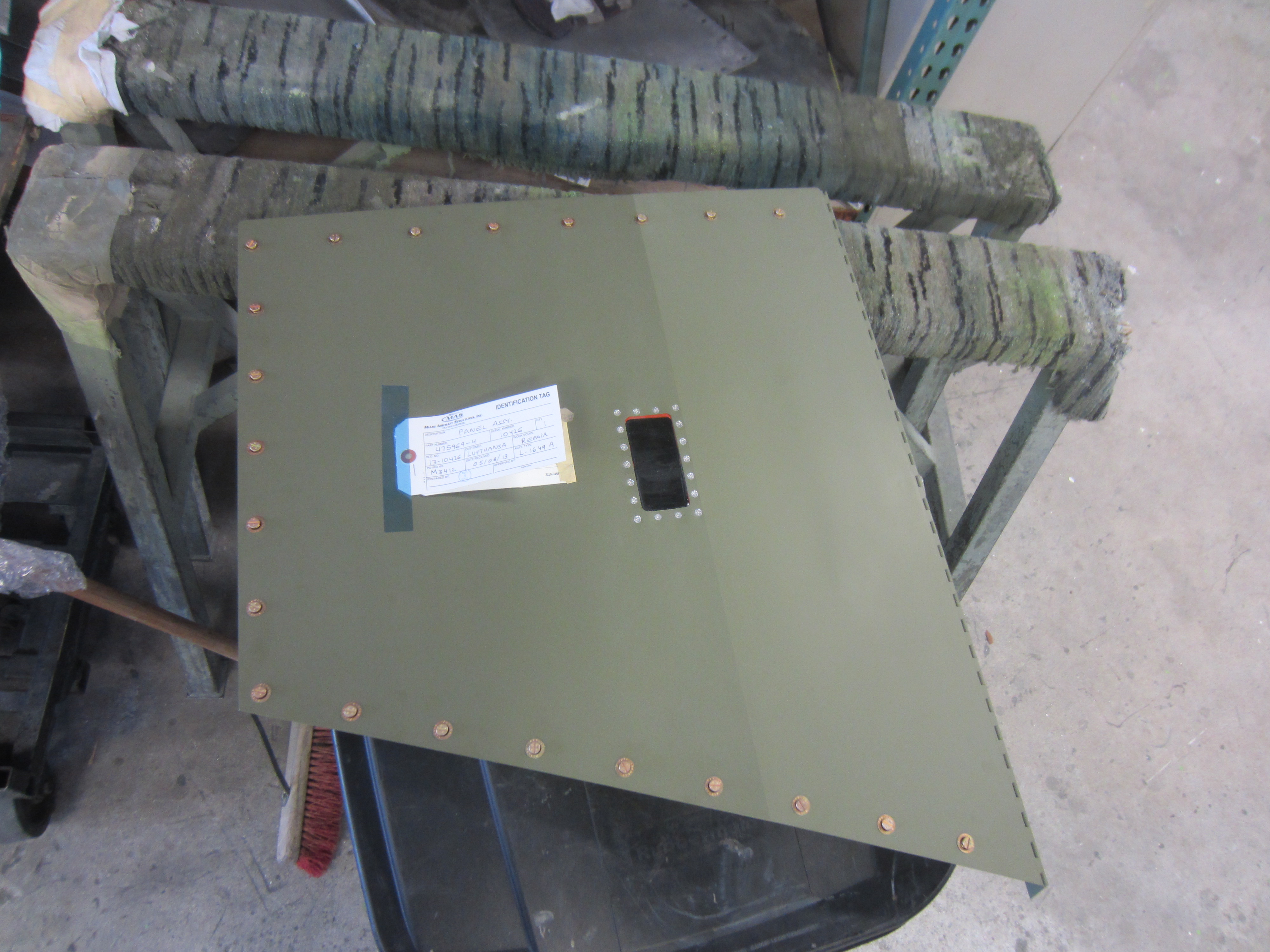

miamiair (netAirspace FAA) 04 Sep 13, 10:33Post
After & Before...

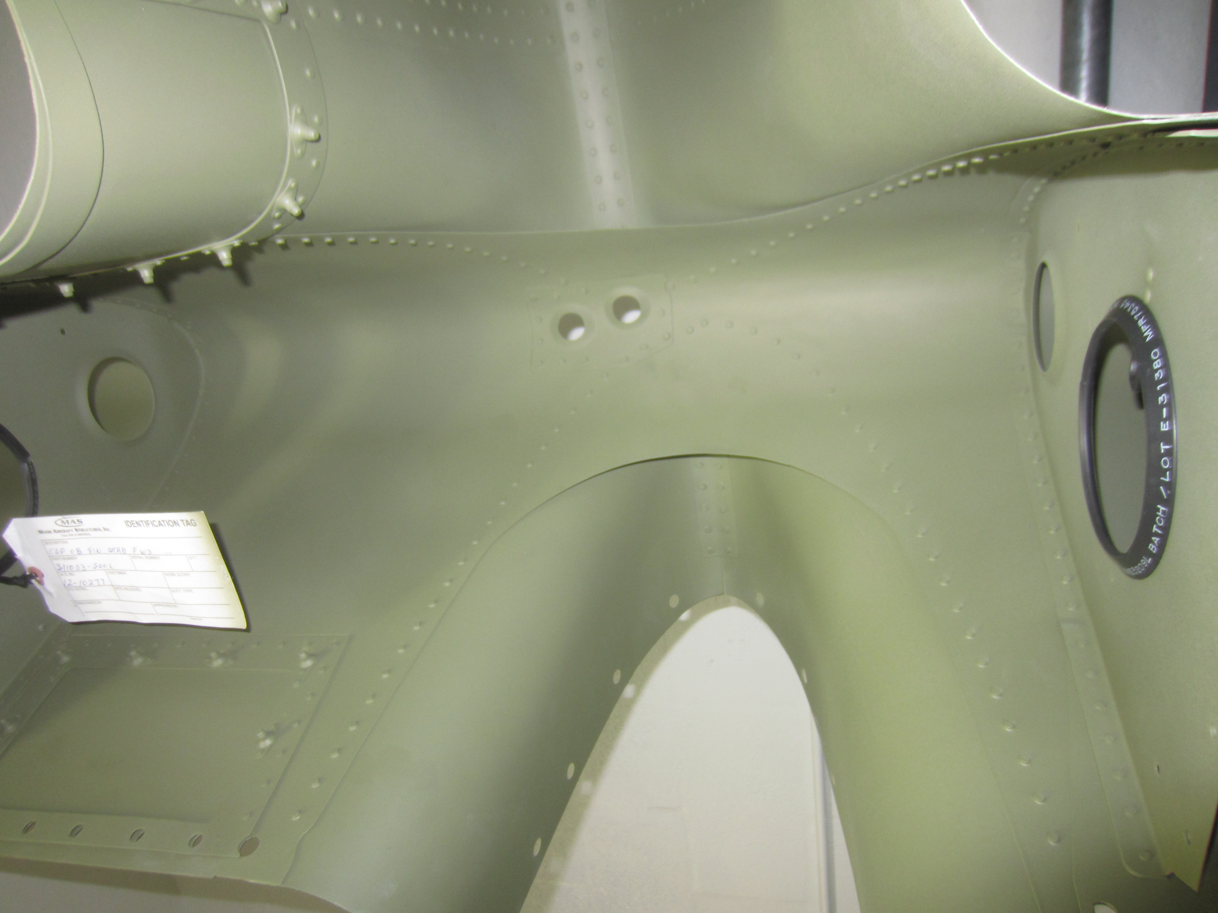

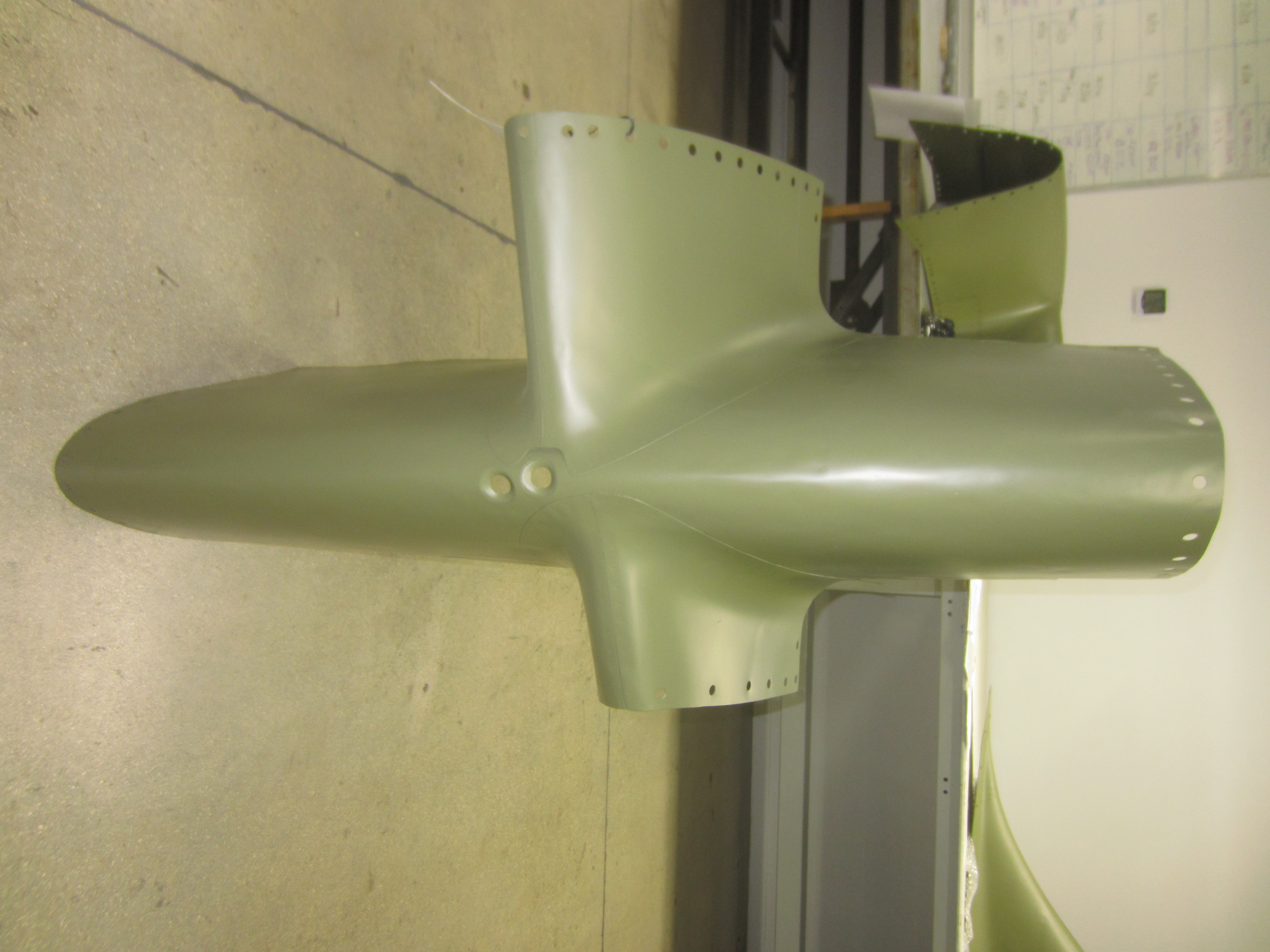

miamiair (netAirspace FAA) 29 Jan 14, 12:03Post
Leading edges for the empennage verticals:

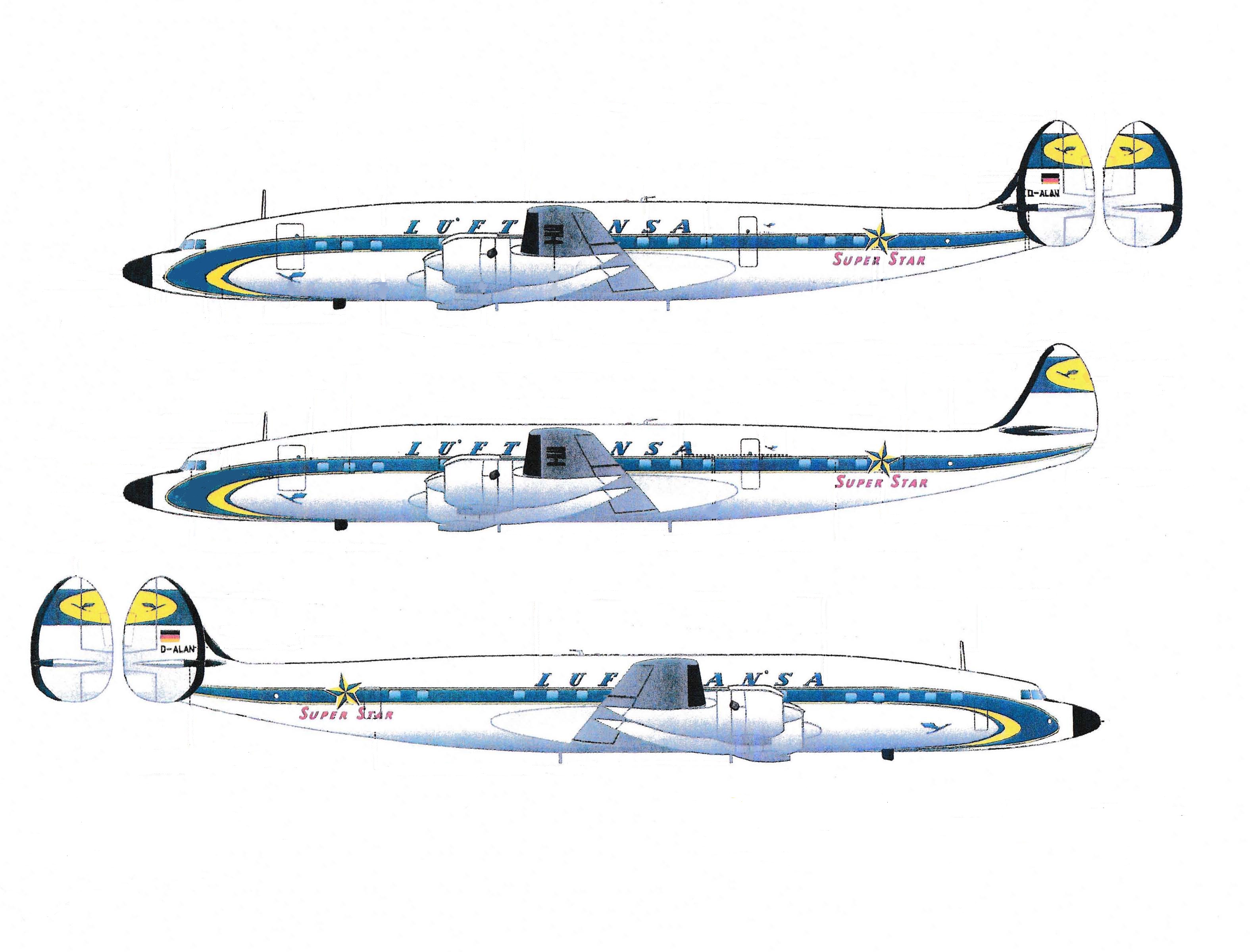

miamiair (netAirspace FAA) 25 Feb 14, 22:19Post
What it is supposed to look like:

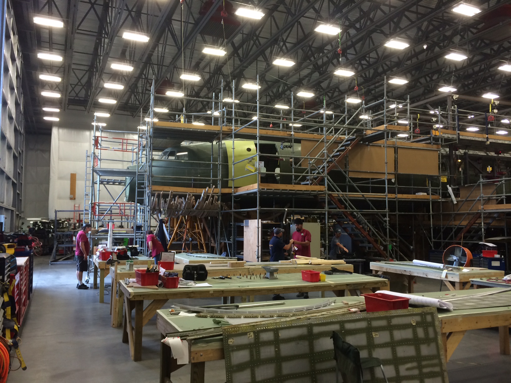

miamiair (netAirspace FAA) 16 Jun 14, 17:42Post
Some pics of last week's visit:

miamiair (netAirspace FAA) 24 Jun 14, 10:56Post
The main entry door is temporarily installed. This was done in Hamburg by LHT. The wings are almost done. The wings are being readied for a pressure check.
An interesting note regarding the wings, during manufacture, the wings are assembled "dry." They do not use any faying surface sealants (imagine buttering your toast, flipping it over and placing it face down on the plate, the butter would be the faying surface sealant). After assembly, all the edges are sealed. This simple fact made the dis-assembly of the wings relatively easy.
The wing leading edges will have all new hinge extrusions that cost an astronomical amount. Goodrich custom made the de-icing boots. The boots are applied bare, in other words, the skin is not primed.
The airplane will more than likely need an STC (Supplemental Type Certificate) to allow the use of 100LL AvGas. The Wright R-3350 988 TC18-EA-2 were designed to use 115/145 AvGas. It is still made in small batches for special events such as air races. The -988 TC18-EA-2s are oddball engines, that is why they are so scarce. The engines have all been overhauled in Idaho. The props have been overhauled.
Engines 1 and 4 each drive a turbo compressor that provides pressurization. The heat is provided by a Janitrol heater that uses avgas. {bugeye} {bugeye} {bugeye}
I thought they were just used in small general aviation aircraft...
The cowlings are 50% complete, then they are going to be polished to a mirror shine.
More pictures next week, headed back up to do some work.

Leading Edge Hinges:
photo 2.JPG (418.44 KiB) Viewed 11409 times
photo 1.JPG (403.84 KiB) Viewed 11409 times

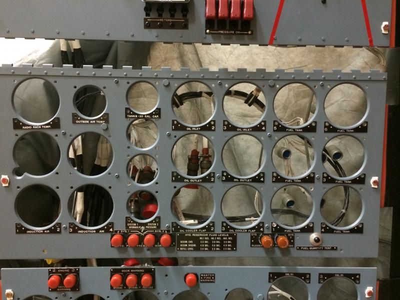

miamiair (netAirspace FAA) 01 Jul 14, 11:40Post
captoveur wrote:I have been seeing online this is getting a glass cockpit similar to that of a C-130J

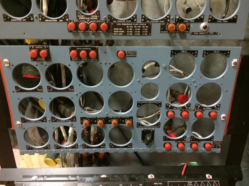

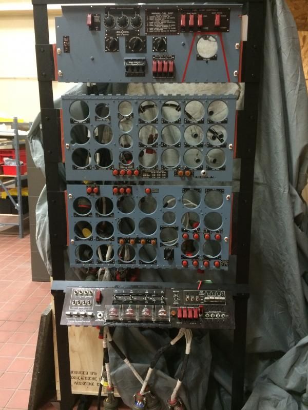

And that they are. Honeywell is donating the hardware. Although the wiring, will be a cast-iron bitch. I'll post a pic later of the engineer's panel. The structural end may be done, but as I've said, the devil is in the details and the wiring. The old style canon plugs are being superseded by modern canon plugs, which require having the pins crimped, and having the compatible receptacles.

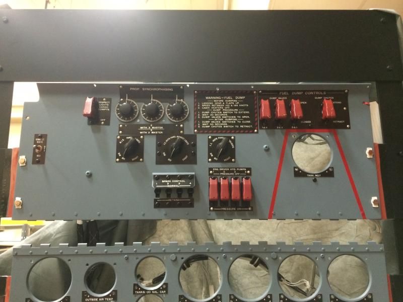

An update...
Details of the flight engineer's panel:

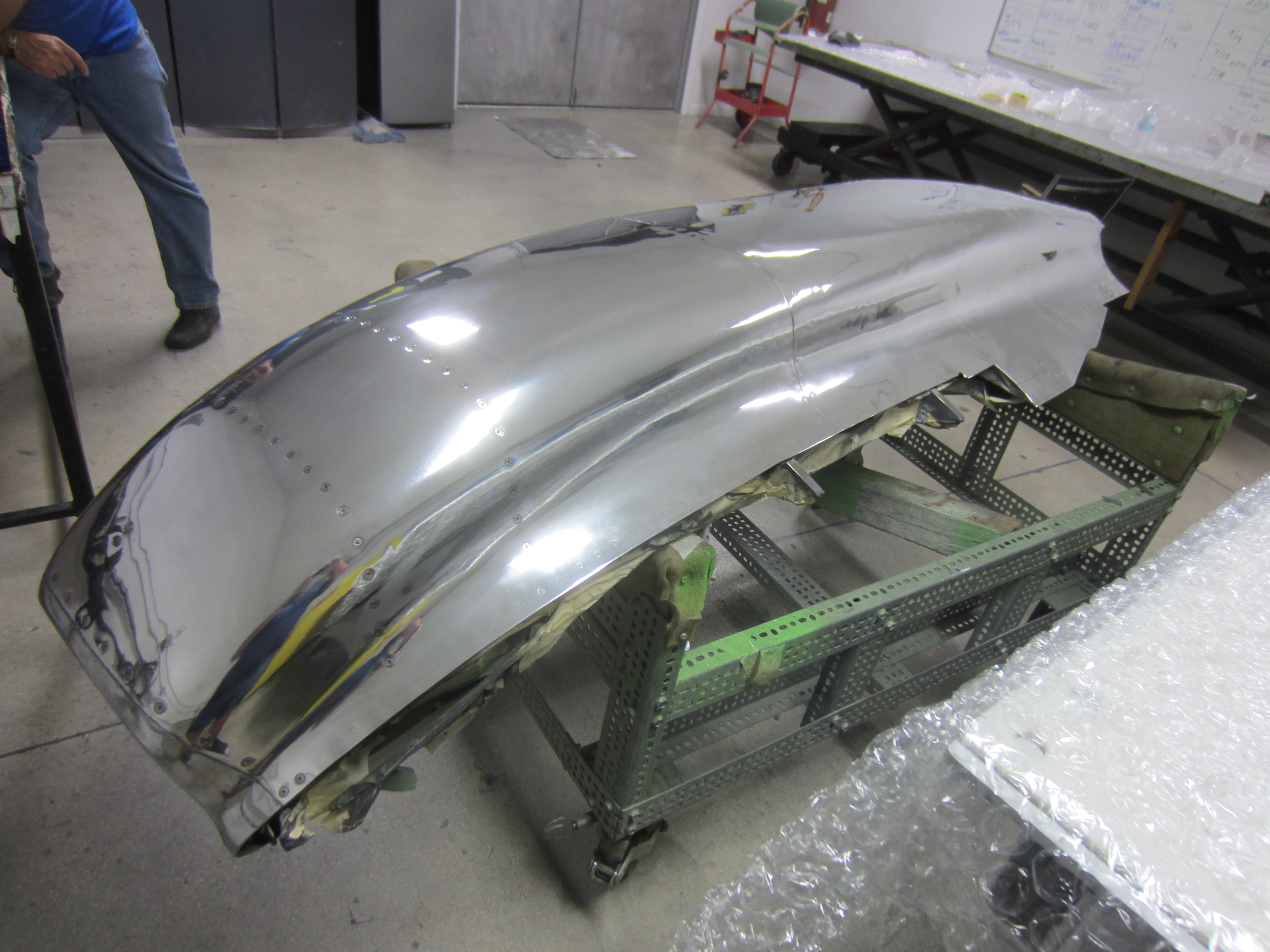

miamiair (netAirspace FAA) 30 Jul 14, 17:50Post
Polish work on some of the cowlings:
