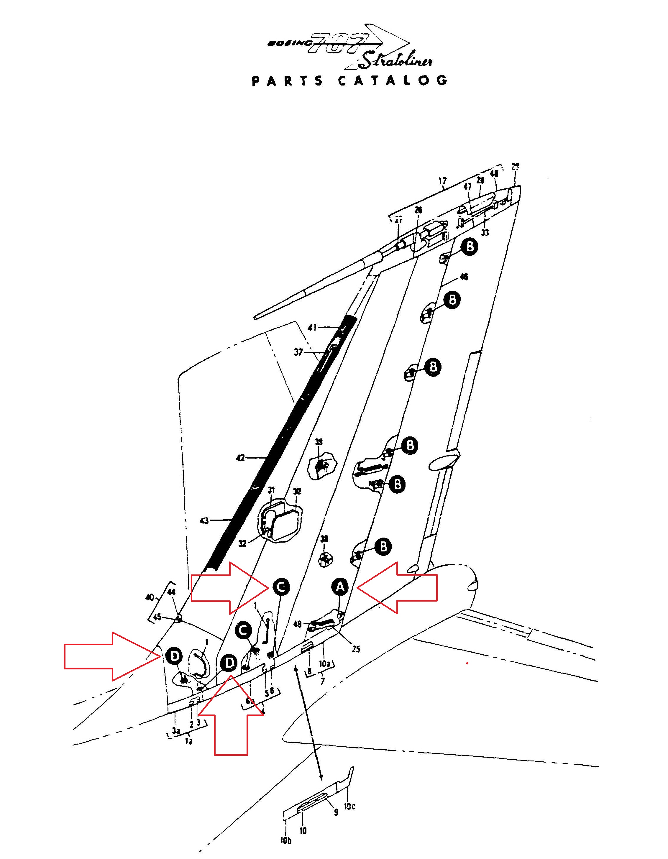

Sounds like it has more to do with how the refueling boom is attached. In any event, it's a 30 minute inspection which means that it's in a pretty easy location to get at. Not like they have to drag them all into the hangar and break them down. Waiting for Vic to chime in as this sounds like they got some bad parts.
miamiair (netAirspace FAA) 21 Feb 23, 10:56Post
That inspection has been around for decades. You remove the access panels and then perform an NDT Eddy Current inspection of the terminal fitting lugs. See the arrows in the image below.
